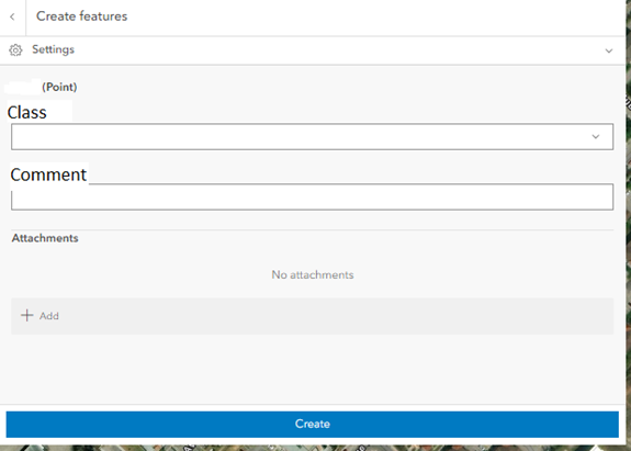

the layer its symboized according to the class, the editing capability its set to attribute and geometry, this is what i get when i want to create a feature: Picture1.pngPicture1.png

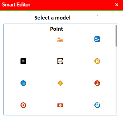

And this what im looking for :

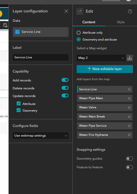

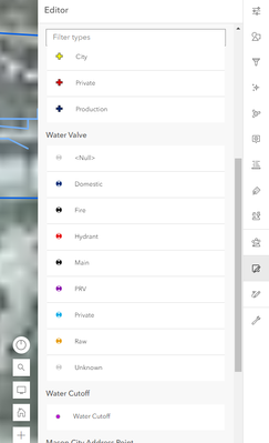

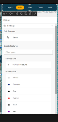

Mine will also automatically let you click a symbol as shown in your 2nd image in EXB.
what do your settings look like?
What does the editing pane look like in map viewer? It should be pretty similar
