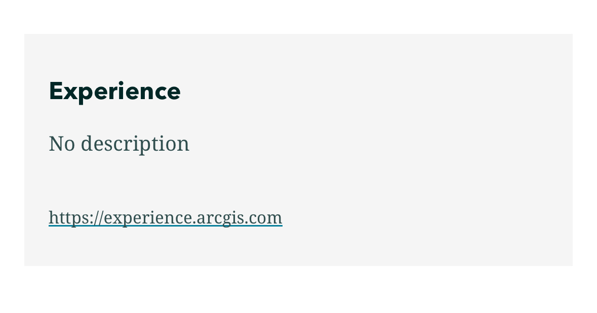

We have an embedded experience builder map in a story map. The embed works great on a computer screen but on a phone I get an error with a link to the experience builder instead
Here is the website (scroll down to "events" on a phone to see issue, screen shot is below)

@Dena-s I have found the solution - in the options of the embedded Experience Builder app, choose the 'Embed options' button and change this setting to 'Live' under the 'Small screens' section.
ShaneONeill_144
Could you update the sharing settings of the Storymap so that I can access it to test?
As an alternative, you could just add a text box with the title and description of the Experience Builder app and then also include the link in there?
ShaneONeill_144
Dena-s
thank worked! thank you!
