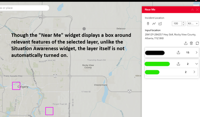

I have a WebApp that utilizes the Situation Awareness Widget to list resources from 40+ layers on a map within the specified radius.

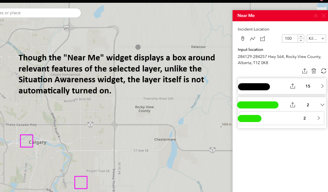

When re-creating that workflow in Experience Builder, based on this blog post, the proper widget to use is the Near Me widget. I've re-created some functionality using this , however a key function missing is layer visibility and toggling.

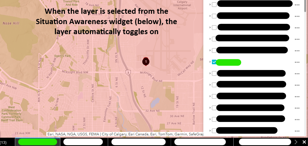

The 40+ layers in the map are turned off by default to prevent crowding the map and excessive load times. When the Situation Awareness widget is used in our original WebApp, any layers with features in the radius get turned on automatically when selected.
From the Situation Awareness widget documentation:
When the widget opens, visibility is turned off for all map layers that have been configured... The layers become visible when used by the widget

Hi, did you mean that you want the layer visibility to be controlled using the Near Me widget? Defining layer visibility by changing the URL parameter might be an alternative but any widget does not trigger it. This function allows you to turn on certain layers when you open the application, even if the webmap is still turned off. Check out here: https://doc.arcgis.com/en/experience-builder/latest/build-apps/url-parameters.htm#:~:text=Define%20v...
I don't think EB has any widget with the same functionality as the original Situation Awareness widget regarding its layer visibility property.

Toggling the layer visibility will require a custom widget.
But, Near Me can still find things with their visibility turned off, if that is a solution.
