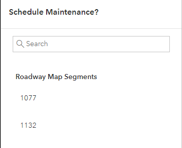

The issue I am having is with the edit widget within the Exp Builder. When I multi-select the roadway feature layer, the edit widget presents these records as a scrollable list within the edit widget.:edit widget.PNGedit widget.PNG
However, these records are not respecting the custom displayField expression that was set in the feature back in my pro document before publishing up to AGOL.

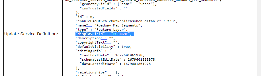

I also opened up the REST services directory as Admin and tried updating the service definition:
My custom displayField string will consist of 4 string fields. Is this the problem? That the displayField can't handle more than one field? Anyone else been able to successfully update the displayField through the JSON, and change it to a multiple string expression?

i answered my own question i managed to get it to display a field other than its object id by changing the display field on the actual feature service for the layer, and it now displays the address in the edit widget instead of the object id
