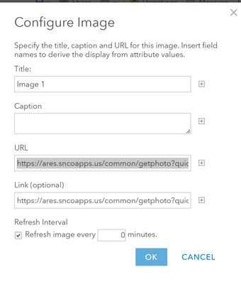

I've got a similar issue calling to an image from the list widget.
We have a working app that provides an image based on a 'RefID' field in our dataset.  This works fine in a pop up created in WebAppBuilder.  Our hyperlink is configured below....where the QuickRefID is a field that seaks to individual images.
https://ares.sncoapps.us/common/getphoto?quickref={QuickRefID}&size=large

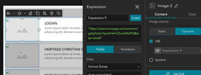

That same statement doesn't seem to work in ExB.  Below is how I have the dialogue configured.
Anyone have any ideas whey this is not working as expected?
BrunoSousa1
Hi Travis,
Try this URL instead: "https://ares.sncoapps.us/common/getphoto?quickref="+{QuickRefID}+"&size=large"
Your expression is treating {QuickRefID} as a string part of the final URL, instead of dynamic data from a column. What I did was to separate the URL into 3 parts, concatenated with the column in the Middle.
You might have to add the column to that position by selecting it from the list of fields below the Expression area, as just typing it might not work.
