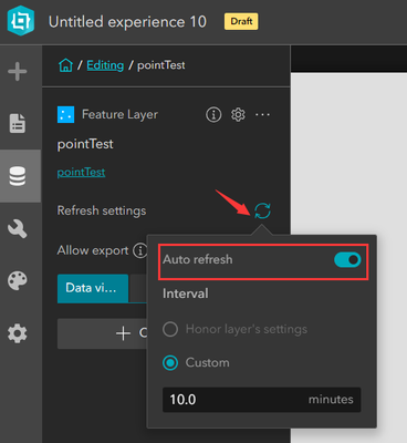

Hi lienpham83,
Could you try to set Auto refresh of this layer in data source panel?
