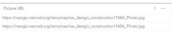

1. In file explorer we will replace outdated photos with new photos when they become available. We will keep the file name the same. For example, 1584_Photo.jpg will stay 1584_Photo.jpg even though the image has been replaced.
2. In the feature service attribute table, the Picture URL will remain the same since the file name did not change in file explorer.
File name in the attribute table. This field is used to populate the dynamic image in the List widget.File name in the attribute table. This field is used to populate the dynamic image in the List widget.

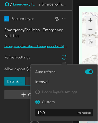

In the meantime, I wonder if the auto-refresh function for data settings will help with the issue:
This will refresh the data without the need to refresh the browser.

@TonghuiMing I have tried refreshing the app as well as closing and reopening the browser but that did not help. I will try applying the auto refresh and see if that works. Thank you!
ChristinaNeal
@TonghuiMing the auto-refresh did not work either.
