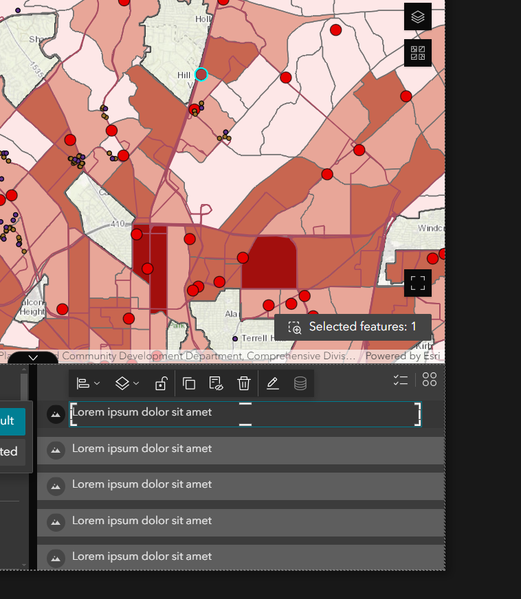

Hi Community,
I am currently having issues with my list widgets when using the Routes Template in Experience Builder. I have set the data source, and the list is showing the correct number of records and is flashing to points when I select a record in the list, but the list text is not displaying correctly. The list is still displaying the default "Lorem Ipsum" text, and not the attribute name. I am new to Experience Builder, so this may be something obvious that I am missing, but please help! You can see in this image that there is an item selected and it is displaying on the map, but the text is not showing right:

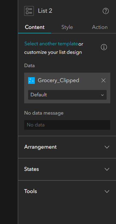

Here is the configuration:

Hi @HenriettaKrellenstein ,
After selecting a data source for the list widget, you can add dynamic content to the inner text widget.
Hi Shengdi,
Thanks so much for your response, this solution worked!
