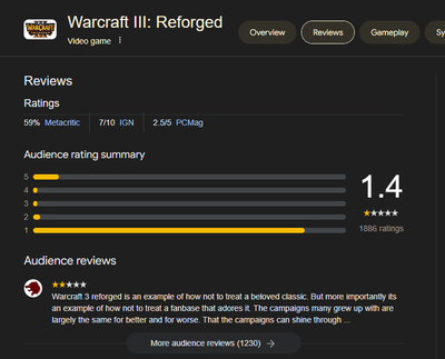

Just look at the backlash and controversy of Warcraft 3 Reforged when Blizzard released it without pre-existing Ladder, Profiles, Automated Tournaments capability, just to name a few. Blizzard then issued a formal apology, and their customers were STILL very dissatisfied. It's STILL sitting at a 1.4 star review because of it. We have all been, and still are, much more patient.
