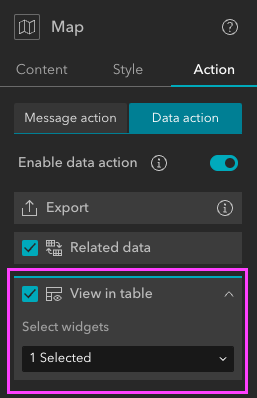

You can go to the Actions tab of Map widgets to uncheck View in Table, then you won't see this option from map pop-ups.
