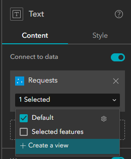

When selecting the data to be used in your Text widget you have the option of creating a view. That is where you can add a filter and/or sort the data.
Select Data
- Jen

Thank you, I tried doing this but it wasn't letting me choose a view for each individual expression. I was doing it all in the same text widget, not sure if that has anything to do with it.
