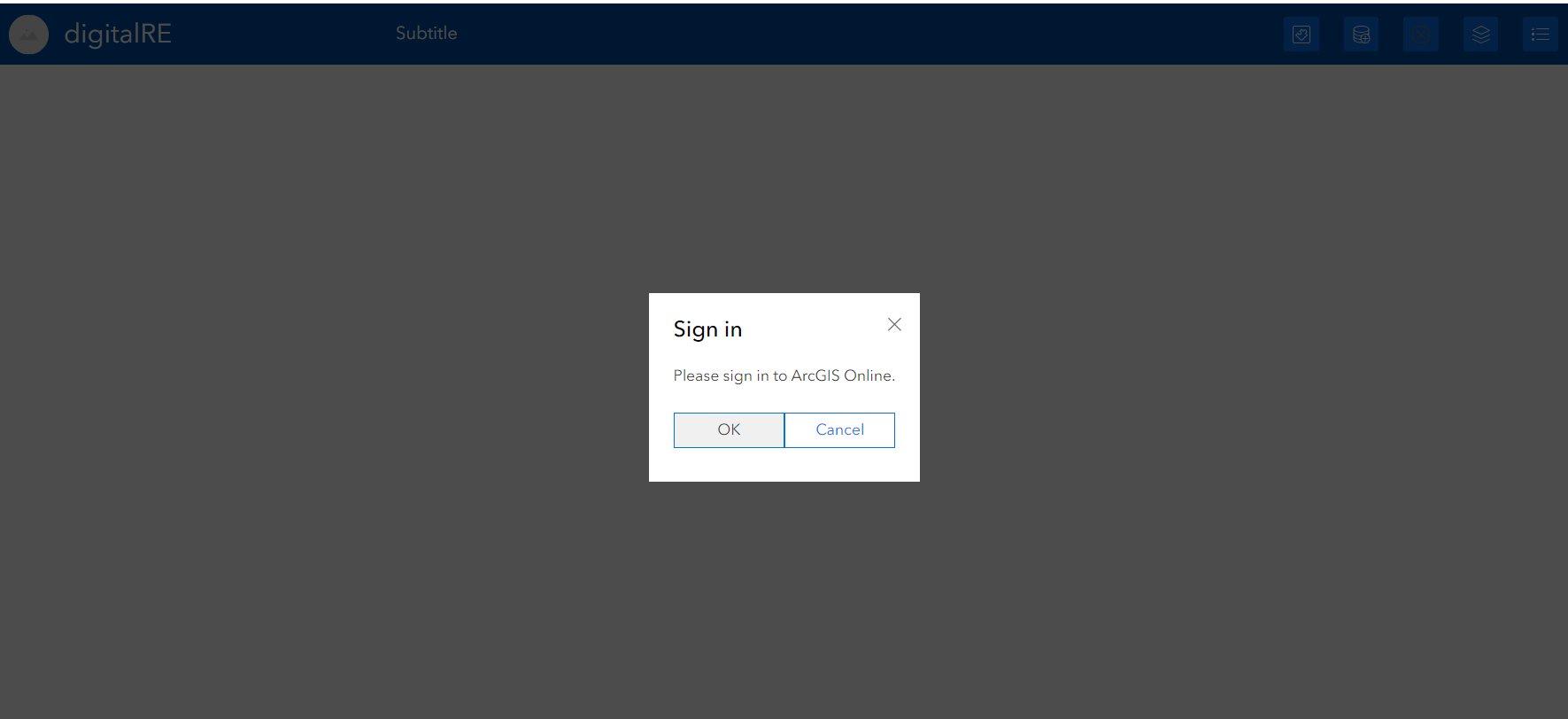

I've created an experience in Experience Builder Developer Edition, it works fine in the builder. I've published it and downloaded it. I then installed Apache (on Windows 11). I tested the Apache installation and it works. I copied the experience over to the area of Apache to display webpages. When trying to view it, it give a box
asking to Sign in.  This did not happen in Experience Builder.

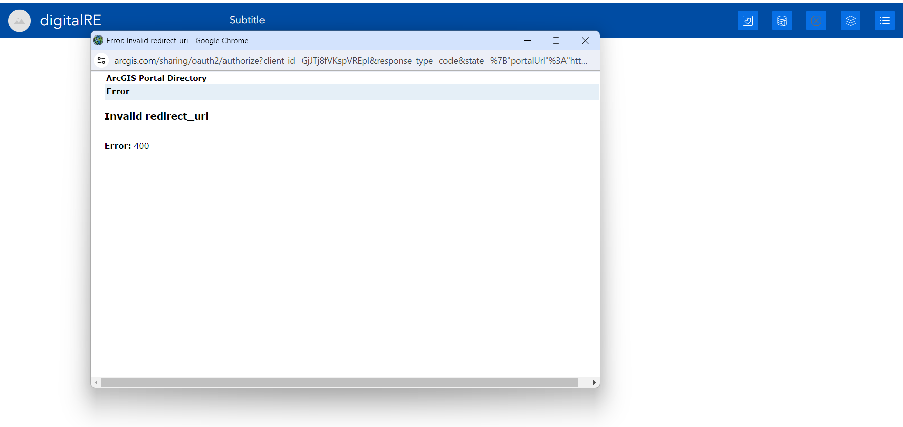

When I click OK, it tells me this:
Looks like it's trying to get to the data at Esri

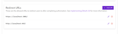

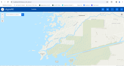

MikeSousa
I think this solved my issue, I needed to add the additional redirect URL:
Now I see my webapp 🙂
