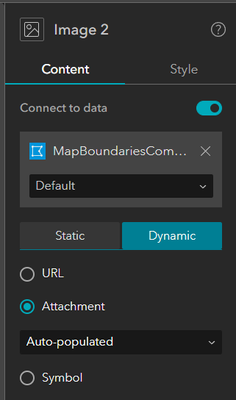

DanielMiranda2
Image widgets that are part of lists can be dynamic. You have to connect it to data in the image content tab (I connected mine to a MapBoundariesComplete feature layer):
It might get a bit messy from here, but two ways to handle this:
1. Use URL. Host your red, yellow, and green images on the web. Then, create an attribute in your data to store the URL, pointing the correct image based on status. Finally, use URL in Experience Builder and set it to that field.
2. Attach the images directly to your data and use auto-populated attachment.

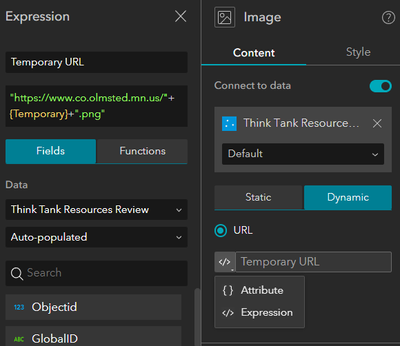

Teresa_Blader
Thanks for the tip! In the same line as point 1... I used URL, with Expression, but wrote an expression that would modify the URL based on the field, and then named the corresponding images stored on our arcgis image server based on the domain structure. No attribute field adding needed!
