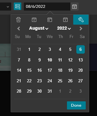

Not able to reproduce - the date is selected correctly:

I am not able to reproduce the issue in AGOL - they date takes effect no matter before or after you click the Done button:
Please reach out to Esri Support and see if they can help you to build a reproducible case, thanks.
