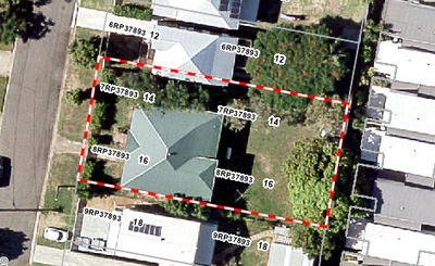

Is there a way to create my own renderer for the highlight color/fill/halo, etc ?  @DavidMartinez
The \arcgis-map\src\runtime\components\mapbase.tsx 's highlight HALO doesn't seem to work.
I need something like this:
