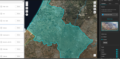

hallow.
I want to change the color of the choice from turquoise to another color.
When I choose a particular polygon, the choice is turquoise but I want it to be a different color.
Is this even possible?
thanks

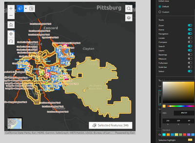

TonghuiMing
@giladuzann @DanPatterson - This issue should have been fixed and the selection change will take effect. Could you please double-check? Thanks.
