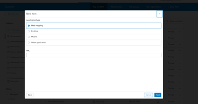

When you provision a custom widget you also have to add it in portal but I'll add one gotcha that has thrown many.
In the portal when you want to add the reference to the custom widget you are hosting you would normally go to new > Application, but if you get there and see this:
And do not see experience builder widget in your environment, then it likely means you do not have sufficient permissions to setup a custom widget and need a different user with a higher license level to reach it. If I remember correctly you have to have portal admin privileges to be able to set that up.
for more information see: https://www.esri.com/arcgis-blog/products/arcgis-enterprise/developers/add-experience-builder-custom...
