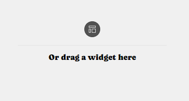

I want to have a custom fonts (e.g. Open Sans) in my theme.
While it seems to work in the preview...:

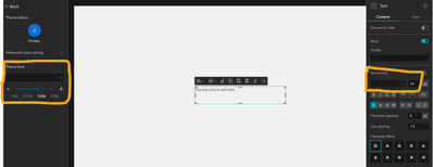

...my custom font is not showing in my fonts list and can't therefore not be used in my widgets

Even properly configured custom fonts will not be shown in the dropdown list in the Builder mode. There will be a blank line in the menu like in your screenshot. Did you try typing in the text box to see if the font is correct?
