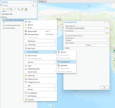

Normally when it comes to combining two tables into one, I would use Joins and Relates in ArcGIS Pro to do that. Of course, it requires the IDs of two tables to be the same. One thing I could think of is to use Spatial join - for example, if ponds from two layers are at the almost same places, you can use a point with a small buffer to find the corresponding one and connect them. 
