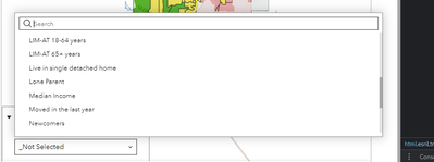

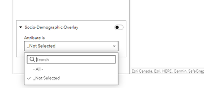

My problem is the list of unique values is no longer populating properly on desktop - the pull-down menu shows only one or two values instead of the full list of twenty or thirty it should be showing.
See the screenshot below.

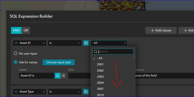

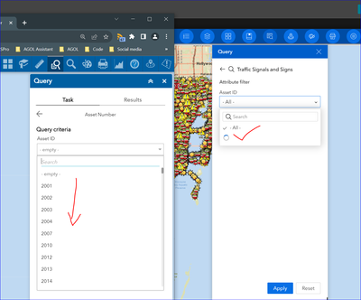

I am having similar issue with the unique values list not populating properly on the Query widget.
Below the same data and widget in Builder, to the left, and Experience to the right.
Thank you

Hello,
Thank you for answering.
Environment is AGOL, data is a feature service hosted in 10.71 ArcGIS server. Data attached.

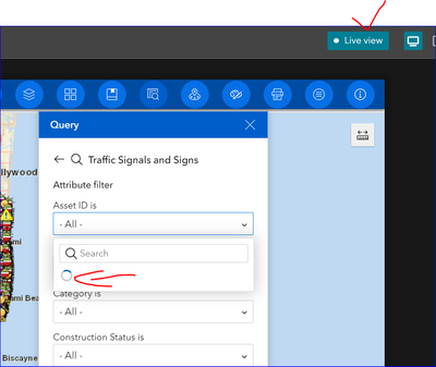

Noted on the Expression builder the values are listed and populated properly once moved to Live view it get stuck.  Thank you
Cepero_Eudel
One more thing, this is happening only with numeric fields. I try with Zip code and got the same behavior.
The Asset ID and Zip code fields are in Long numeric format.

Cepero_Eudel
Update.
There is ESRI BUG-000161315 on this.
Our findings. Attribute query on a map server produce an Input Geometry in the REST that is making the query to fail, see REST image. When this Input Geometry in the REST is deleted the query works.
In addition, if you remove the “return distinct values” and keep everything the query works with all the parameters set by the Experience Builder call. See error in the database image.
We have tested the same Attribute query in the same layer but hosted in AGOL without any problem.
