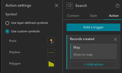

It can be achieved by adding a Records created message ction:
  • In Search widget settings panel, go to Actions, add a trigger "Records created"
  • Select a Map widget as the target, choose Show on map
  • Select Use custom symbols, and change the point symbol to a pin
However, it only works for locator sources at the moment.
