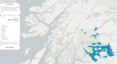

If you're meaning something like this, then I'm happy to share how this was created.

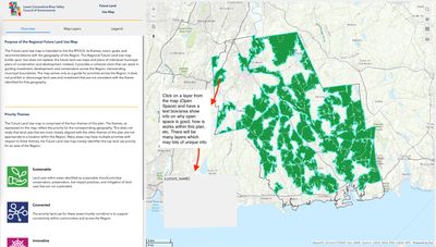

Maybe? I am not sure how your map is working. I provided a screenshot of my map so far. Again, the open space will be one giant feature within it's own layer so when someone clicks on the green area they can learn more about OpenSpace in general, or another topic depending on what they click. Does this make sense?

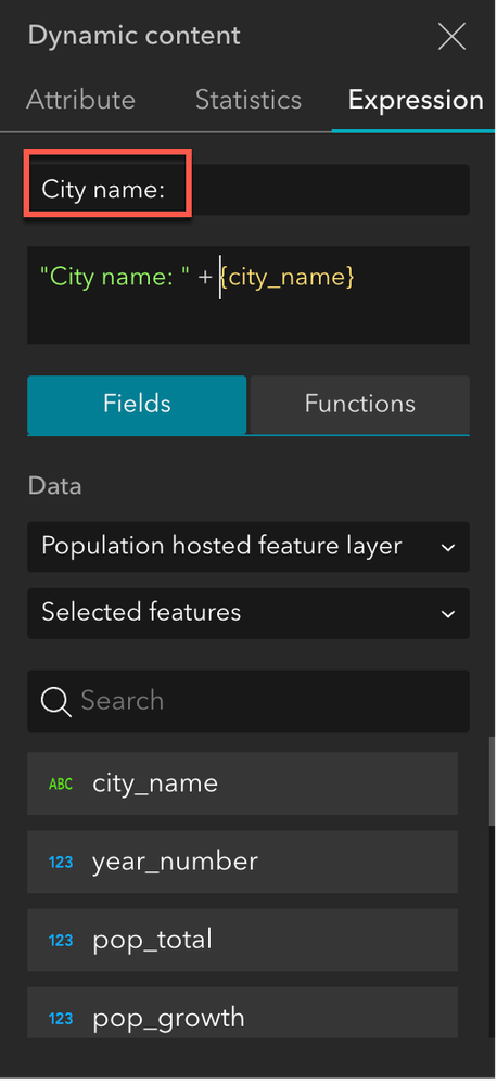

The text widget can be connected to multiple layers. To avoid showing a placeholder for non-selected layers, you can use an expression in the dynamic content panel. This will display the expression title when no features in the layer are selected.
