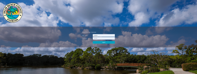

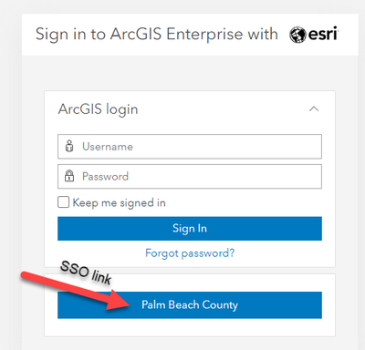

I'm not quite sure what you mean, how do YOU log in?  We use an SSO, to login to Enterprise we click the link to our SSO, then put our SIM credentials. See image:
Which takes us here:

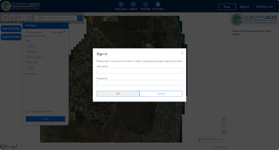

Oh, i know, something like this:
Did you use developers ed of EB?  Can the people in your org sign in first and then access the app?

Yes exactly that !
And yes I use developer edition of experience builder.
If people sign first in their account, they can access to the application. But it would be better if when I send a link to my colleagues, they can also choice to connect by the SSO and not with this strange login/password popup.
