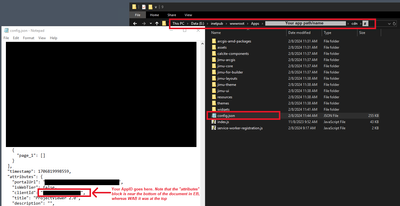

So EB works like WAB in that you need to add the AppID to your exported EB. Check out steps 4-6 here.
This gives you an SSO popup (assuming you are configured for SSO). The one thing that I seem to be missing is the popup component... assuming it still exists. In WAB, it was jimu.js > tokenUtils.js > popup: false,
JasonBOCQUET
Hi @abureaux thanks for your answer. I already do that; the AppID is correctly writted on the config.json files.
