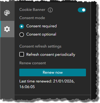

We're in the process of building an app that will be public-facing.  We're in the UK so have to get consent to store cookies.  We've enabled the cookie banner in the 'privacy and security' section of ExB:

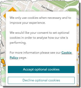

...and configured the cookie consent window as follows:
This all works fine.  When users press either the 'accept' or 'decline' buttons the cookie consent window disappears.  In the settings section, if we press the 'renew now' button, anyone who has previously accepted or declined cookies will see the cookie consent window again and will have to accept/decline again.  This is all working as expected and as per the documentation from Esri.

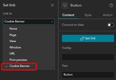

Hi @MappyIan ,
You can reopen the cookie consent window using a button widget.
In the set link dropdown list, there is an option called "Cookie Banner":
Thanks,
Shengdi

ShengdiZhang
Hi @MappyIan ,
Thanks,
Shengdi
MappyIan
Perfect, thanks @ShengdiZhang, that's just what I was looking for.
