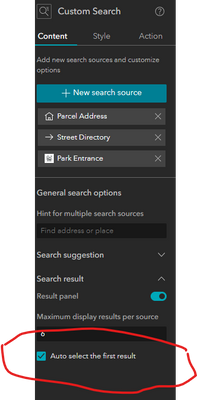

Do you have the "Auto select the first result" option turned on?
I have discovered that when this box is checked the search widget will ignore the user's chosen data source and return data from the first data source with a valid response.
I got around this problem by capturing the click event in the suggestion-list.tsx, passing it to result-list.tsx and overwriting the dsId and configId in onSelectRecord

I do have this selected, but unfortunately, I am looking at a different issue.  We only have a single locator added to the search widget (the composite locator), so there aren't multiple sources it could be selecting from there.  Turning off that checkbox doesn't affect this specific problem.
This morning, I think I'm going to duplicate the search widget and set the magic key to be blank when sent to the 'find address candidates' to see if this provides a workaround on the issue (without introducing new problems).
