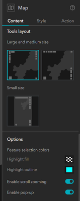

I would like to display a star icon in the map widget for the currently selected feature(s). Is there a way to do this?

Any method that can be used to select a feature. Click on it in the map, select it from the list, etc.  The default method of distinguishing what is selected is by means of a highlight. I have found that this does not provide enough in terms of distinguishing the selection.

I didn't see how to change the symbol -- but i did see where to change the selection color ... which i was looking for when i found your post ...
