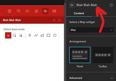

I have an edit widget but would like to change the title of it. Below I have attached an image circling what I want to change. Thanks!
marksm_macomb
In experience builder, first click on the edit widget to bring up its properties pane, then you should be able to just click the title and type whatever you want here:
