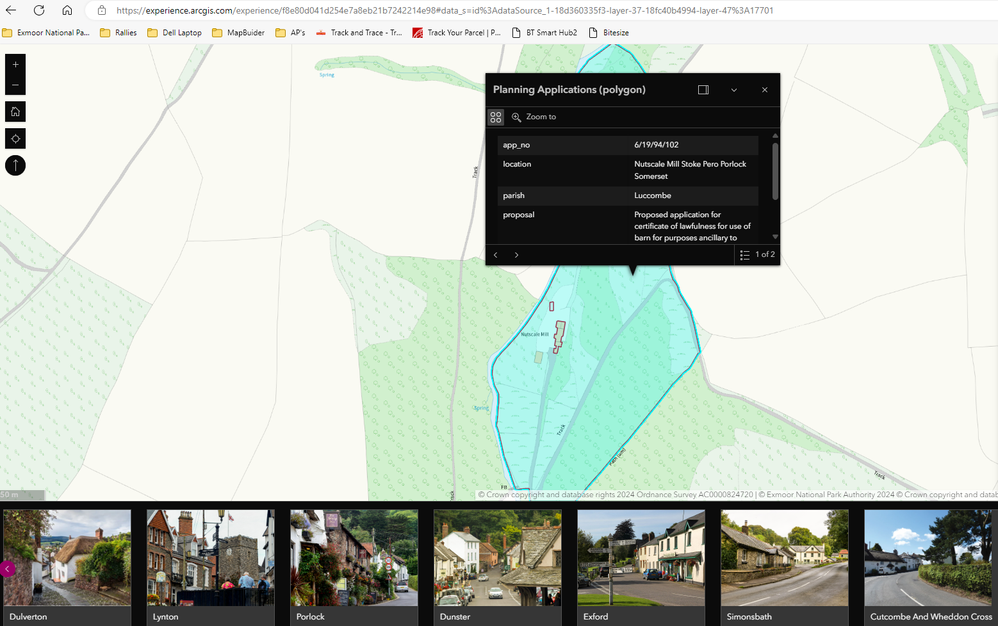

What I need to do is to display a map of planning applications base upon some criteria.
So for example, if we have a planning application with reference
app_no
6/19/94/102
app_no is the column name
6/19/94/102 is the planning application reference number
Can I just display this record with the surrounding basemap from a predefined Webmap.
I have set up a planning webmap and the associated layer.
https://experience.arcgis.com/experience/f8e80d041d254e7a8eb21b7242214e98#data_s=id%3AdataSource_1-1...
This is for that particular planning application.  Is there any code I can put with this to zoom to that particular application?
Would it then be a question of putting another column in the layer that is the link to the locations of these individual planning applications.
Not sure if I am explaining this very well.
Many thanks
Matt

MattSully
I take your point yes I could do this, which would work.  What I am after is that in the url it zooms automatically to the feature "6/19/94/102"
Can I add, zoom to in the url.
That's what I need as a solution to my problem.  Yes of course the user could instigate this, but the start destination of the map needs to be the actual feature in question....
Thank you.
