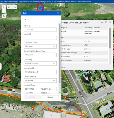

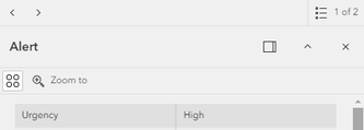

Hello,
I've created a Web Map which I've loaded into a Web Experience. The Edit button is included on the feature pop-up in the Web Map (below left) but it doesn't show up in the Web Experience (below right). How do I include the Edit button in the Web Experience?
Thanks in advance 🙂

Hi @COwen, The edit button doesn't show up on the pop-up window. Possibly log it as an idea.
As far as I am aware the flow is -
Open the Edit Widget -> Select your object -> Make changes in Edit Widget ->Hit Update.

Yes, I have an edit widget set up but this still doesn't show an edit button on the feature pop-up window.

Hi @gis_KIWI4,
Thank you for confirming that is the case. That is the flow that I currently have.
