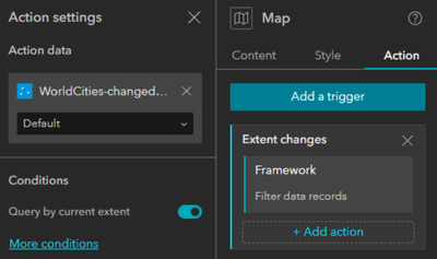

On the map widget, you can add an Extent Changes action which filters the data records shown throughout the app:
Then, when you connect a text widget to Dynamic Content, you can use the Statistics tab to define your operator (SUM in your case, not COUNT as shown) and then the field which gets summed.
