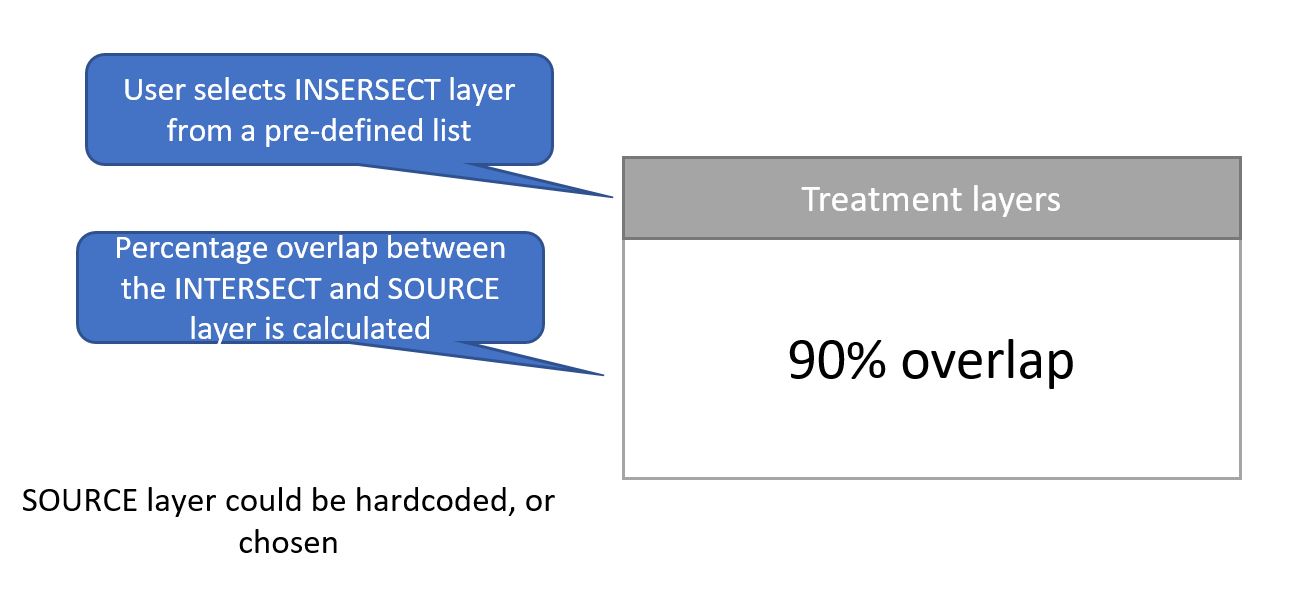

In ExB I'm struggling to determine an approach/widget where I could leverage Arcade to accomplish this.  Conceptually this is what I'm hoping the user would see, with an understanding of the % overlap being goal, and the presentation being flexible:
User workflow would be to:
  1. select an individual polygon from the project area layer
  2. Choose which weed they are treating (and thus individual the "treatment benefit" layer that we will use in the calculation)
  3. View the percentage overlap
A variation of the above is when the user is creating a new record via the edit widget, and they'd want some timely indication of the overlap so that they can adjust the geometry to reach the target of 90% overlap
