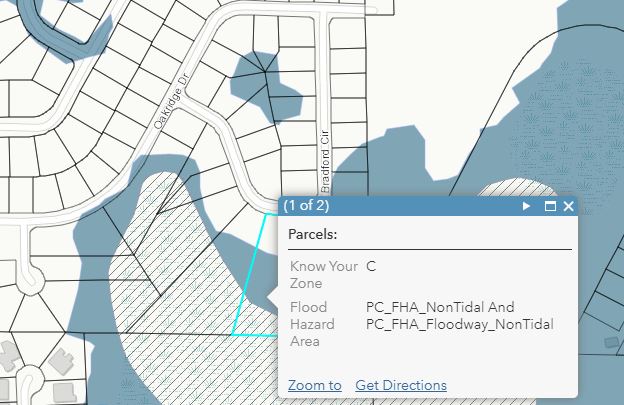

Here is what I have so far:
var intersectLayer =Intersects(FeatureSetByName($map,"PC FPs nonTidal Regulated"), $feature)
var Hazard = "";
for (var f in intersectLayer) {
if (Hazard == "") {
Hazard = f.PC_FHA
} else {
Hazard += " And " + f.PC_FHA;
return Hazard
What I am looking for next is when there's a parcel that intersects both PC_FHA_NonTidal And PC_FHA_Floodway_NonTidal, I want it to return the option with a higher risk for instance PC_FHA_NonTidal. The parcel referenced is within both areas (hatched and blue symbology) and I want to default to the higher risk flood answer (whatever it ends up being- this is for proof of concept at this stage). The end goal is to have all the risk layer intersections added to the parcel layer for customers to find out information but I am stuck when there are multiple options for a specific parcel boundaries. The popup will end up being very similar to the floodplain inquiry solution but more specific parameters because I want to default to a specific answer when multiple intersecting options are found. Does that make sense? Thank you!

Thanks for branching your question.  It makes sense what you are saying, but in order to determine the highest risk, you will need to use some sort of dictionary of the possible PC_FHA value and the risk level. Do you have such a table?
AllisonGoldberg1
Hello Xander Bakker
Thanks for your response. I don't have the dictionary or "key" from the customer yet on the different hazards and zones but if I provide you with a hypothetical one, would that work? For instance, say the possible options for PC_FHA values are A, B, C, D, and E  zones. With zone A hypothetically being the lowest risk and zone E as the highest...or a score from 1-5 with A=1 risk (lowest risk), then B=2 (moderate), then C=3 (slightly more moderate), then D=4 (higher risk),  and E=5 (highest risk potential). Let's say the parcel shown above is split between Zone B and Zone D, I would then want the expression to only showcase D. Does that help you formulate the language?

AllisonGoldberg1
This is really thorough, thanks Xander Bakker. When I tried inputting the new attribute expression (called Highest Risk Test) in the webmap it didn't work (just removed third option to mimic scenario) and the output is blank. I know this is just an example but it should've mimicked it. I have a group created in our AGOL, can I add you to it to take a look at the data in context?
