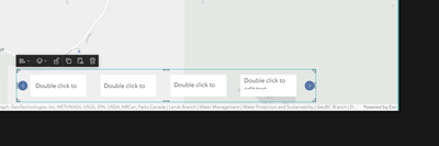

KitKat94
That is a great suggestion about the bookmarks.  By using your suggestion and the "list" style template its pretty close to what I wanted! Only wish I could have the buttons distributed horizontally, but I might be able to customize that.
Thanks!

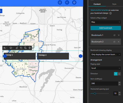

JeffreyThompson2
MVP Frequent Contributor
If you select one of the Advanced Templates, you can fully customize the appearance of the bookmarks, including the direction.
GIS Developer
City of Arlington, Texas
KitKat94
That is helpful thanks! However do you know if there's a way to remove those arrows? Otherwise I think they have no function when the bookmarks are spread out.  I'm just hoping to have my four groups displayed so when the users (who aren't familiar with ESRI products) open the application they can see the four options.
