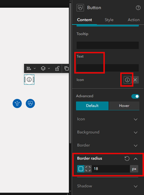

One workaround is to use a standalone button outside of the controller. Here's a suggested button widget setting to achieve a similar visual style:
To ensure the standalone button aligns visually with the controller, you can place both the controller and the button inside a Fixed panel widget, with the size set in pixel (px) units.
