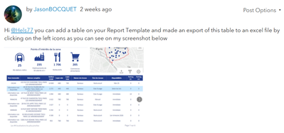

JasonBOCQUET

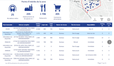

Hi @Hels77 you can add a table on your Report Template and made an export of this table to an excel file by clicking on the left icons as you can see on my screenshot below

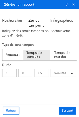

On Experience Builder you have a Business Analyst Widget to do that.
you can search with an adress, place a pin or draw a polygon on the Map Widget.
Next step,
you create your buffer, it can be a travel time zone, walking time zone or circle.
And by using this area zone, you can generate your report with a table in the template.

in my original post i show to you one of my template :
There is a table in this template
