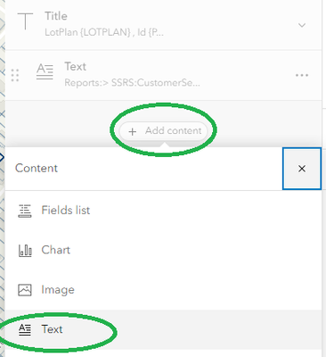

The best is to edit a smart popup in your web-map itself.
  • in Portal, select and edit your web map > open in Map Viewer
  • select one layer
  • in properties > edit POPUP
  • Add a text content
  • Edit , use hyperlinks, or even image <img>
  • Click that "source" button and save it in plain text (good old notepad)
  • Save your web-map

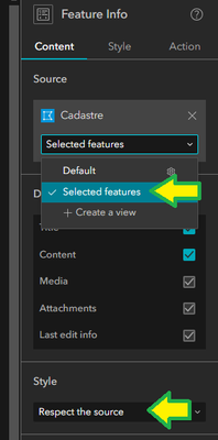

    Back in Experience Builder,  add a "Feature Info" widget and place it (say) in a side panel
  • Select your layer and tick "respect the source" (meaning 'use the popup as designed in my webmap ')
  • Select your webmap widget in ExB, and scroll all the way down in the parameters
  • turn OFF the "enable popup" - i know - it's counter intuitive but it tells ExB to NOT display the floating popup on the map.  BUT it will send the selection to your Feature Info widget.

Thank you for this Frederic.  I have tried this, nearly successfully.
However when I first open the Experience, the Feature Info box  that I have now created to replace the popup, starts by showing the first of all the records in the entire table as a default view:
When I select an individual record it does correctly display the pop up for that address, but I need it to be blank before any records are selected.
Have I missed a simple setting somewhere?
