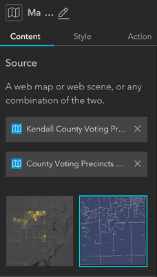

In the Map View widget, you can add two maps.

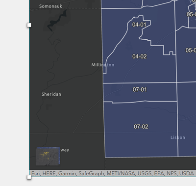

Once added, you'll see the switcher thumbnail in the lower-left.
Clicking that switcher will toggle the maps. It's not quite the same as the basemap switcher, as this will switch out not just the basemap but any layers on the corresponding maps as well. But suppose you made a copy of your map and just changed the basemap, it would be about the same as the other basemap switcher.

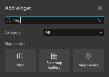

This is exactly what I'm looking for, but I only see the Map widget. I don't even see it listed in Esri's list of basic widgets. I've seen it in Instant Apps and was hoping to put it in an Experience Builder template also.
Where do I find it?
