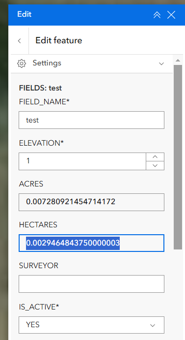

Hello, I have an Experience Builder in ArcGIS Online. I have both the edit widget and the table widget in my app, they are pulling from the same web map. For one of the polygon layers I have arcade expressions set in the web map to calculate acres and hectares. In the edit widget, these attributes are greyed out and can't be edited:

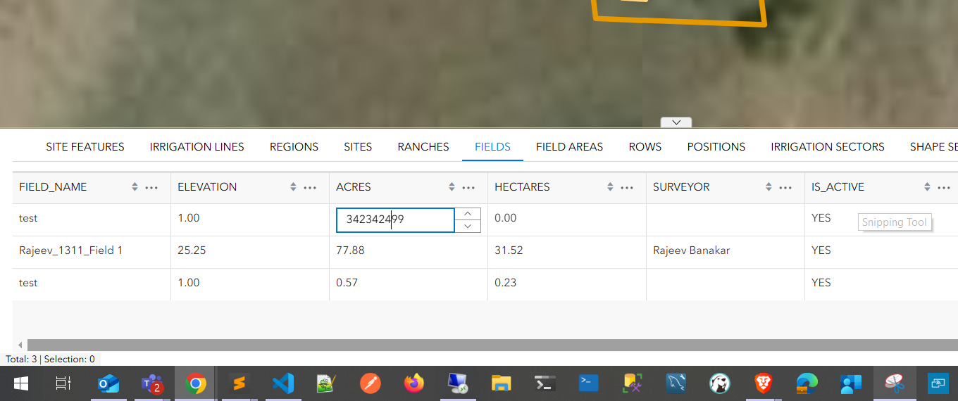

However when I open the table:
It is allowing the user to edit both attributes. Is this the expected behavior? I am wondering if I am doing anything wrong.

A few points that may help answer your questions:
  • Arcade calculated expressions need to be configured in Forms to calculate attributes automatically when editing in the Edit widget. When a calculated expression is set for a field in the Form, that field becomes read-only (grayed out).
  • Calculated expression and editability settings configured in Forms do not work in the Table widget, they only work for the Edit widget.

Have you tried turning off editing for those fields in the table widget?
vl-driscolls
If I disable editing for the fields where there are calculated expressions, they don't seem to re-update. Still, it is better than letting them edit

Are there plans to have calculated expressions and Forms settings work in Table widget eventually?
AlixVezina
@vl-driscolls I don't believe so. The Table widget functionality in Experience Builder is actually based on the FeatureTable from the ArcGIS Maps SDK for JavaScript.
If this is an enhancement you require, please feel free to log a new idea in ArcGIS JavaScript Maps SDK Ideas - Esri Community
