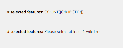

Re: the function name showing when you do Dynamic Content -> Statistics, I prefer to just use Dynamic Content -> Expression with the same expression you'd calculate in Statistics, since you can give it a title that will show when no features are selected (this is nonsensical, but you get the idea--top is Dynamic Content -> Statistics, bottom is Dynamic Content -> Expression):

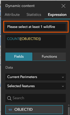

To give it a title, just replace the default "Expression 1" title with your text:
