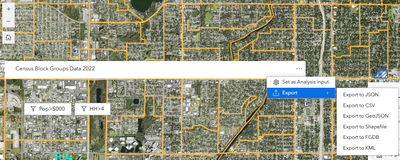

Why is there not an easier methodology for users to export data in experience builder (AGO). I have a simple app with a dozen different toggle filters. I want users to be able to set the filters and export data. Why isn't there just a simple export data widget? Seems I need use an unrelated widget and then rely on users figuring out to click the buttons in the upper right to open the export tool?
-Ben

Thanks for the response but this is slightly different than what i am trying to accomplish. The extract tool relies on users having an AGO accounts as that is where it exports to. I would like users to be able to direct download. This is already possible through several widgets but all of them rely on users knowing to select the "3 dots" menu. The easiest user interface i can find so far is adding a "map layers" widget where the only option is the "3 dots"

As a workaround, you could include text instructing users to click the three dots.
BenjaminMittler
Yep, thats the workaround i'm using. Its not exactly aesthetically pleasing as the Layer List font/color can't be changed, so it doesnt match the rest of the page.
