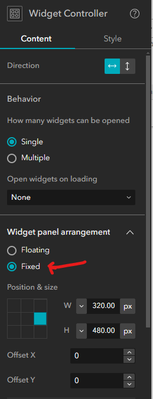

If I'm reading your question correctly, you have a Map Layers Widget in a Widget Controller and you want to control its size and position. This is controlled in the Widget Controller settings. Your options will depend on whether you are using the Floating or Fixed Widget Panel Arrangement.
Setting the option to Fixed will allow you to place the widget with the box grid and its size with the W and H options.
If you chose a Floating Panel, you will not have direct control over the widget placement. It will be automatically placed based on the location of the Widget Controller. However, you can control its size.

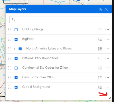

Click on the Map Layers Widget then find the little right angle in the lower-right. Drag to resize. This will be the default size of the widget.
Using a Floating Panel Arrangement, you can have a different size for every widget in a Widget Controller.

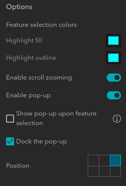

In the map widget's options:
You can choose to auto-dock them and where.

Thank you. This is exactly what I was trying to do. I had originally had 5 widgets in one widget controller, so I was not seeing these controls. But I have since broken them out into individual widget controller boxes to get this functionality. Really appreciate the assistance.
