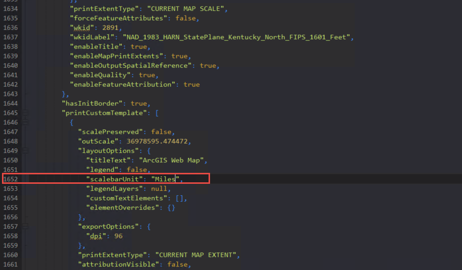

I am currently configuring a new app in Experience Builder Developer version 1.12. I have added and configured the "Print" widget. There is no option in the default settings, to change the Scalebar units. The default is currently in "Miles" and I need it in "Feet".
I found where I can change the "scalebarUnit", in the app "config.json" files. As soon as I Publish/Update my app, the default changes back to "Miles."
Where can I change this in the code to make this default permanent? Is there a jimu file that controls this setting?

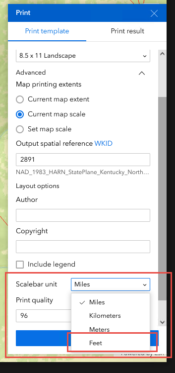

You can change the default Scalebar unit in the templates of the Print service. Simply open a template and change the Scalebar unit in the Layout options.
EllieLinden
The scalebar unit can be changed, but it currently only has 4 options: Miles, Kilometers, Meters, and Feet. I'm hoping there can be an additional option for acres.
