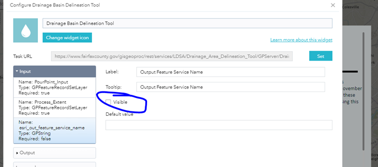

The major issue we have found is there is no way to configure the widget to not create a feature service. In WAB if I uncheck “Visible”, the results are added to the map and not too AGO My Content.

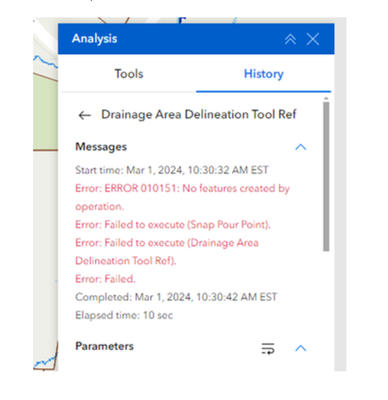

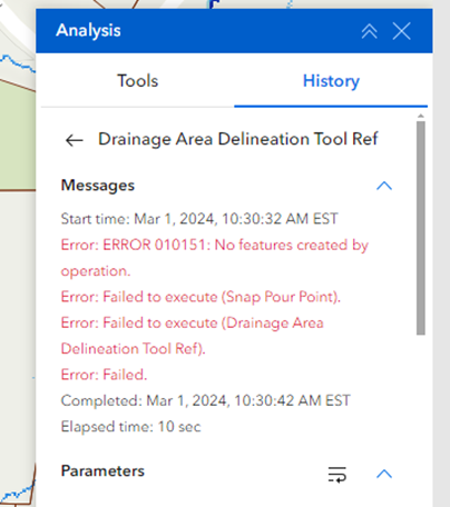

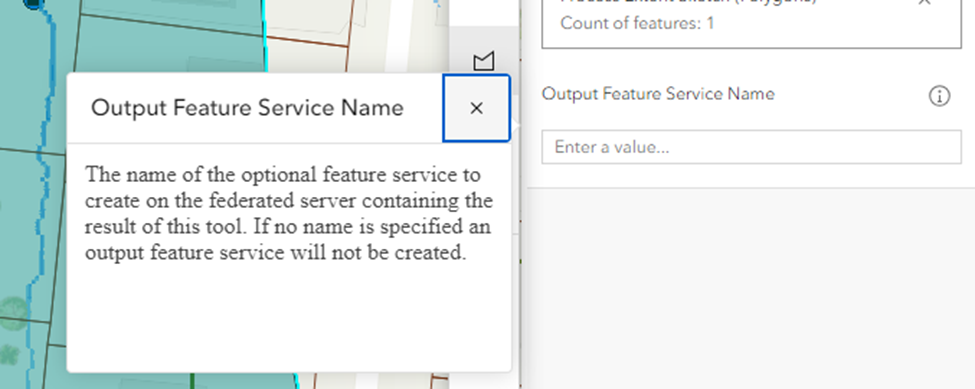

In Experience Builder, there is no option in the builder. The hint in the app GUI states if left blank a feature service will not be created.
However, if left blank the tool fails.

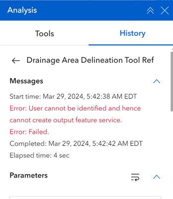

Thanks for you getting back to me.  I am receiving the error below signed into AGO when I do give an output name.

For the error when you providing the name, it is because the server hosting this GP service does not allow you to write data to it so you cannot creating the output feature service you named. You have to check the portal permission. Please check https://pro.arcgis.com/en/pro-app/latest/help/analysis/geoprocessing/share-analysis/use-web-tools-wi...
The portal user must have privileges to create an output feature service. The only roles with this privilege are Publisher and Administrator. For portal users with a custom role, that role must have Members/View, Content/Publish hosted feature layers, and Content and Analysis/Standard Feature Analysis privileges.

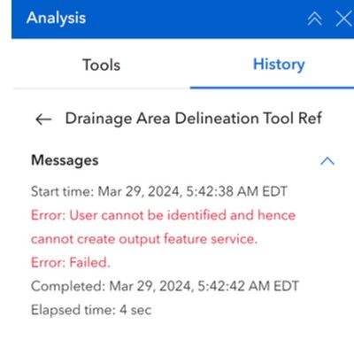

Below is the error message when we do not give an output service name. When you make this not visible in WAB there are no issues. See the app I sent above.
