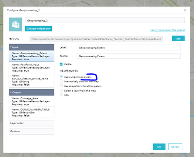

We have a public geoprocessing service in this AGO application in WAB. I have been testing the most recent updates to the Analysis Widget in Experience Builder. The ability to draw the input parameter on the map is a great improvement. However, the widget is still missing functionality that is available in the WAB Geoprocessing Widget. The input configuration is missing “use current map extent” for the extent parameter. There are not options for configuration of output popup or symbology.

More importantly we need to same options from WAB for the extent parameter. Currently users will have to draw a polygon for the extent of processing since "current map extent" is not an option like WAB.

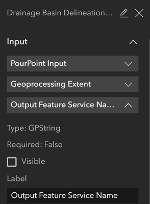

YES! I need this. Having to explain to my users to NOT enter a value is not good.

@JeffLegato1  they fixed this one a few updates ago. You can now leave not visible and there are no errors.
