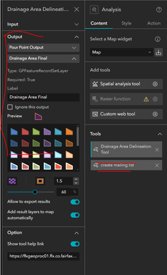

The tool is now working! However, after testing several other tools I have several new requests. We had the ability to configure the output pop up in WAB.
Also, I love having the ability to have multiple GP services in one widget. However, can we get an option to edit the names of the tools? Seems to be pulling straight from service name.
Wei_Ying
Hi @BrettMartin1 Thanks for the feedback. For your request.
So far we don't have that plan. But in future we may enhance to support.
We are working on enhance to rename the tool label.

We need the ability to configure the pop up of the output.

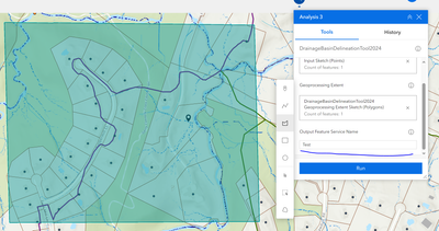

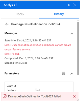

Thank you for getting back so quickly. I have one more request. The tool will run with "Output Feature Service Name" blank. Which you all fixed and previous release. However, if I enter a service name while logged into my AGO account, I get the error below. Can have an option to make "Output Feature Service Name" not visible. This was an option in WAB. This is very confusing for public users to tell the not to populate the text box.

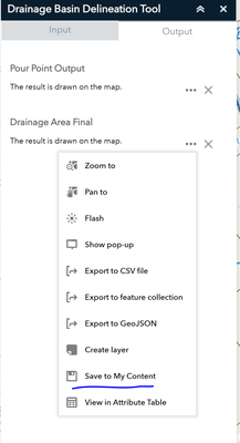

The export results is also limited from the options in WAB. The "save my content" was very useful for users who do have AGO accounts and use ArcGIS Pro.
The "Allow drawing on the map" is also not optimal. In WAB the widget recognized my feature set parameter was a point and only gave the option for a point in the tool. EB gives all the option below which is also confusing for public users.
