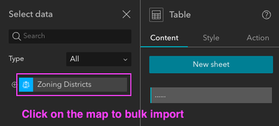

Shen_Zhang
Hi Alex, bulk import is currently in ArcGIS Online (since June 2024 update) and will be available for the upcoming Enterprise 11.4.
To bulk import all the layers to a table, simply click on the web map - all the layers will be imported. It's pretty straightforward so there's no option for this function.

AlexAurica
Good morning and thank you Shen,
I see the issue then - it's not in 11.3. I suppose I will check against
AGOL. Appreciate your help!
-Alex
