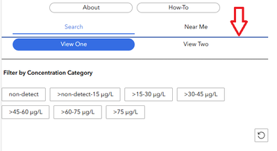

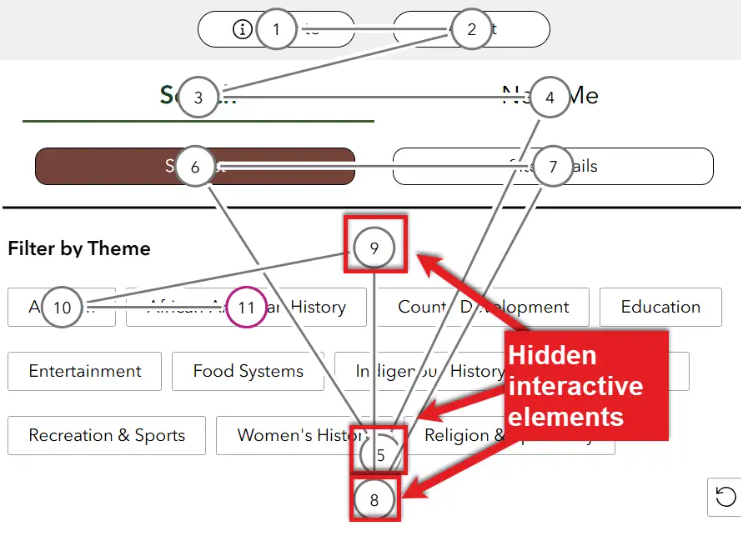

We just had our accessibility testing done on our Experience Builder application. We found that there is an issue flagged for column section. Each column section/widget seems to be a "hidden interactive element" where there is keyboard focus applied to that column section. However, that causes an accessibility issue because it's unclear what is being focused on and there is nothing the user can do, making it an unnecessary "stop".
Can anyone from Esri or users advise or provide guidance - is this something that can be resolved for column sections? Are columns generally not advised to be used for accessibility reasons?

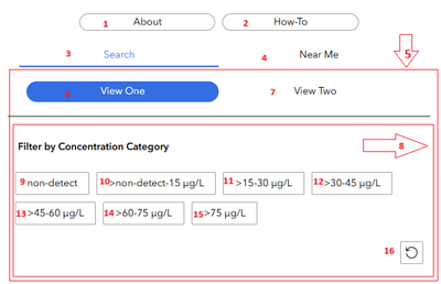

Shown in photo #1 is the error with the 9, 5, 8 as hidden interactive elements due to the column widget. Also some are nested within one another (in terms of how I built the app) - shown in photo #2 below.

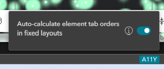

I haven't gotten into as much Accessibility testing as I should/will need to. Have you tried clicking the A11Y button on the bottom bar? Does it help?
GIS Developer
City of Arlington, Texas
Tiff
by
Hi @JeffreyThompson2 Thanks for your note! I thought I had it turned on but for some reason it was toggled off. it did not seem to fix the issue though, still two or three hidden stops as a result of the column.

Hello again @TonghuiMing and @NicoleJohnson - thank you both! I have some updates that help direct us to next steps.
First, the padding certainly helped for focus number 5 and 8. Our accessibility testers said as long as there is a focus element, it does not violate any accessibility issues. This resolves all of the widgets within the column section.
However, the column section itself, which is focus number 9, does not have a focus indicator by default and I cannot seem to set one. This is an accessibility issue because there is an invisible stop.
Here is the app - Untold Stories - though this is shared publicly, it is not yet shared widely with anyone, so please keep that in mind. If you try tabbing through with your keyboard starting with the "How-to" button, you will see that all of the elements have focus except for #9.
Please let me know if you have any other ideas or support to fix this out-of-the-box, or if this needs to be logged as a bug.

Sorry for the delay - things have been hectic for the past weeks. I've checked your app, and here are my findings:
- When I tab through the elements, #5 is actually the focus of the outer section view:
- #8 is the inner section view
And yes, setting the padding will expose the focus ring (this was suggested inside the doc and blog). Glad it works out.
For the problematic #9, yes, we've noticed it in some cases too - somehow the rich text (text widget) grabs an extra focus, and it shouldn't - if there is no link configured inside. This is something we need to investigate further. I will create an issue, and feel free to create a support ticket if you need to track the progress. Make sure to pinpoint it as about the Text widget (there are some different cases regarding hidden focus, and most of them are not from the same reason - I will need to further check the reason):
Hope it helps, thank you.
