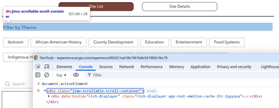

We just had our accessibility testing done on our Experience Builder application. We found that there is an issue flagged for column section. Each column section/widget seems to be a "hidden interactive element" where there is keyboard focus applied to that column section. However, that causes an accessibility issue because it's unclear what is being focused on and there is nothing the user can do, making it an unnecessary "stop".
Can anyone from Esri or users advise or provide guidance - is this something that can be resolved for column sections? Are columns generally not advised to be used for accessibility reasons?

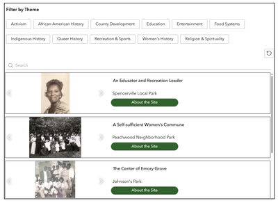

Shown in photo #1 is the error with the 9, 5, 8 as hidden interactive elements due to the column widget. Also some are nested within one another (in terms of how I built the app) - shown in photo #2 below.

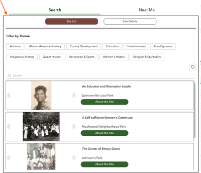

However, the column section itself, which is focus number 9, does not have a focus indicator by default and I cannot seem to set one. This is an accessibility issue because there is an invisible stop.
Here is the app - Untold Stories - though this is shared publicly, it is not yet shared widely with anyone, so please keep that in mind. If you try tabbing through with your keyboard starting with the "How-to" button, you will see that all of the elements have focus except for #9.

- When I tab through the elements, #5 is actually the focus of the outer section view:
- #8 is the inner section view
And yes, setting the padding will expose the focus ring (this was suggested inside the doc and blog). Glad it works out.
For the problematic #9, yes, we've noticed it in some cases too - somehow the rich text (text widget) grabs an extra focus, and it shouldn't - if there is no link configured inside. This is something we need to investigate further. I will create an issue, and feel free to create a support ticket if you need to track the progress. Make sure to pinpoint it as about the Text widget (there are some different cases regarding hidden focus, and most of them are not from the same reason - I will need to further check the reason):
