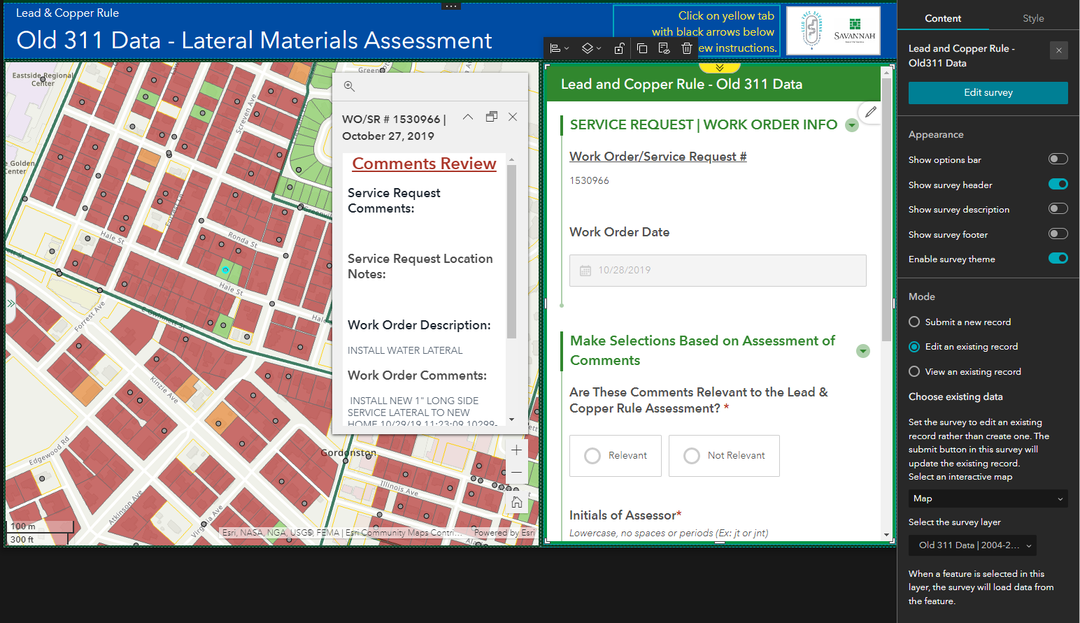

I am creating an interface for non-gis staff to evaluate comments in old records, and answer questions based on those comments in a corresponding survey. I have run into an issue at the very end of the project....
I hope someone here can help solve this riddle! There are a few pieces to this, so I hope I can break it down to communicate this clearly. Here we go!
1) I have a survey that is writing to a feature class hosted in Portal and brought into my organizational account.
2) The survey is shared "globally", but the feature class is not shared. In EB the survey is editing an existing record (this might be where my issue lies but not sure).
3) A map service published to an internal server (so many non-gis staff can access the map data without an AGOL account), which creates a map image. I added this to a map in my organizational account, added to the EB. The map is shared "globally". And I have connected the Survey to the Map (as you might be able to see above).
4) The Experience I have built is shared "globally". So, although someone outside of our organization's network could access the experience, they will not see the map, or be able to access asset information tied to the survey. They can see the survey questions, which is fine.

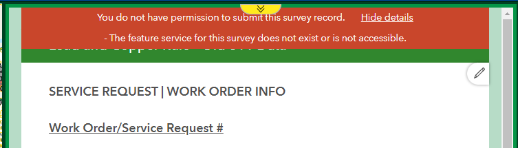

5) Here is the issue.... Experience builder is requiring me to share the feature class (from step 1) at the same level as the survey that is writing to it, in order to submit a survey. When I do not, and I am not logged into an account, it gives an error message seen below.
I cannot share these data beyond our organization.
